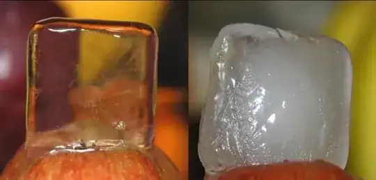

A common trick to make clear water ice is to boil pure water prior to freezing it. Why does that work and what are the white inclusions in ice that was made from unboiled tap water?

  • The water is the same (both from the same tap) and was filled in identical cups to freeze. The room temperature water had a roughly 5mm thick layer of clear ice on the sides, while the boiled water was completely milky. The water that was boiled and allowed to cool, as well as the water that was shaken had the same color as the boiled one. – DK2AX Jul 03 '16 at 16:15
    Are those cubes sitting atop an apple? – Insane Jul 03 '16 at 20:02
  • @Insane yes, it seems like that. (Picture is taken from the internet) – DK2AX Jul 03 '16 at 20:59

  • I'm a big fan of how the pictures here demonstrate that apples are the single best device for use as support in experimental documentation. Which probably explains why scientists always ask "But does it look different on an apple?" when confronted with controversial experimental results – Jim Jul 04 '16 at 13:04
  • @DavidRicherby as yes, I thought of that too afterwards. This seems to support that shaken water also results in cloudy ice. As far as I know, decreasing the pressure also degasses a fluid. This would then be the simplest and quickest solution to receive clear ice (provided you have access to a vacuum pump) – DK2AX Jul 04 '16 at 13:48
  • @Jim You are free to find better pictures of this effect. I happened to prefer this one, since it clearly shows the difference and was easily available online. – DK2AX Jul 04 '16 at 13:49
  • @andynitrox I think more people have access to things that can boil water than have access to a vacuum pump... – David Richerby Jul 04 '16 at 13:55
    @andynitrox No, no. I like the picture. Science needs a bit of whimsy – Jim Jul 04 '16 at 14:06
