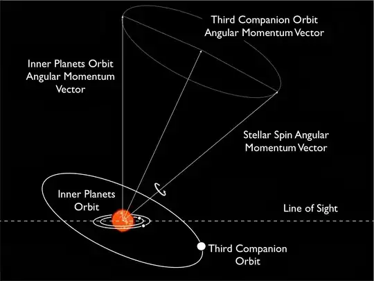

Various data from Kepler and stellar modeling allows the inclination of the orbit to be determined. Several SETI Seminar videos goes into this in some detail. Whether the eclipse cuts a little bit or straight through the middle of the star and the statistics that indicate complete misses are consistent with random orientations without enough data to see if they are biased with the galaxy rotation.
This talk tells us stars are oriented randomly, and they can tell which way it's pointing and which (different) way the planet's orbits are.
Enter image description here
Also text here
To measure the rotation of the star in Kepler-56, the authors looked at oscillation modes due to a combination of pressure and gravity waves inside the star. Certain pressure-dominated and gravity-dominated modes will split in a unique way depending on the inclination of the star’s rotation axis. The authors model the splitting of six modes to derive the star’s inclination. Because the planets transit, their inclination angle is very close to 90 degrees. Therefore, any angle different from 90 degrees for the star’s inclination is a direct measure of obliquity.
The advent of steroseismology via other instruments and exploration as a new viable technique will give more varied data as to whether we're looking at the side or top of a star, or whatever degree in between. But existing spectra (a mature field) already provide that: more Doppler broadening if you are looking at the side, none if looking down at the pole.
The transit also causes a spectral shift as it shades the limb rotating toward or away from us, and the rate of rotation varies with latitude. So these measurements (I can't find a video that goes over such detailed geometry) give more.
This paper talks about inclination, but I could not find a SETI Seminar video that went over the data analysis that explains how you can infer inclinations.
Estimates of the inclination of a transiting planet come from the impact parameter b which is the projected distance between the center of the planet at mid-transit and the center of the star, in units of the star’s radius.
They know whether the planetary system is edge-on, just clipping the side of the star's disk and thus barely transiting, or something in between. Most of the time it misses completely, but the statistics of the ones we see and the number of those we don't see are presumed to be random, which is necessary to figure out the percentage of stars with planets (at all) even though we only see those that are approximately edge on. Since the amount of tilt that will provide a visible transit varies with the size of the star, size of the planet, and distance of orbit, the statistics can be diced rather well to look for any sign that the tilt is not truly random.

  • You need to develop your argument more clearly. All of this refers to determining the inclination of stars and their planetary systems. This is not the same as knowing the orbital plane. You can rotate the entire system through 360 degrees and get the same observational signatures. – ProfRob Sep 08 '15 at 09:58
  • Yes, there is an ambiguity around the line of sight. It would be suspicious if they were all the same inclination but presumed different angles relative to our particular sight line! If they were not uniformly distributed in the ways we can tell, I'm sure there would be some effort to see what the absolute plane was to see what everything was biased toward. – JDługosz Sep 08 '15 at 10:40
  • Really not following this at all. The talk you reference has no bearing on this problem (at least the 5 minute segment I watched) and simply determines the inclination of a star and then shows that the planets in this system are misaligned with the stellar rotation axis. Ditto the other sources you refer to. They merely determine inclination. – ProfRob Sep 09 '15 at 06:24
