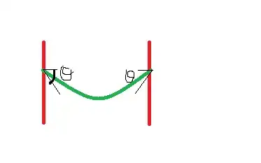

Then the next part of the question was that if the rope now hangs between two fixed points which are at same level, then what would be the tension in the rope at its lowest point?
The answer has to be expressed in terms of mass of string m, acceleration due to gravity and $\theta$ where $\theta$ is the angle that tangents to the rope make with the horizontal.
I took that force acting on lowest point is mg, since it is center of mass and hence T = mg. However, according to the answer it depends upon $\theta$ as well. However, I failed to see what I was doing wrong?

For the second question- COnsider the string to be made up two parts separated by a vertical line passing through the lowest point.
Now, consider the point where the string meets the wall.The string exerts a force on the wall(Normal force,tangential to the curve at that point) and in trun experiences a force in the opposite direction.
Now resolve these normal force on the string into its two components. The horizontal component is balanced by the tension force which the string experiences on the lowest point due to the pull of the other segment of the string.
Also use the fact that the vertical component balances the weight of the half-segment of the string.
Solve for tension.

  • Thanks for the explanation. I understood why $N \sin \theta = (mg)/2$ but why isn't the horizontal component of normal force N by wall equal to the sum of all the horizontal components of the tensions at all the points? Why is the(horizontal) tension at the lowest point alone equal to the horizontal component of normal force? – Swapnil Rustagi Jul 16 '15 at 10:51
    when we consider the half-segment as a an individual body.. the force on it due to an external object,ie the wall, needs to be balanced by another external force, which is in this case the pull of the other half segment(which is external wrt the segment in question) on the segment in question.The internal tensions cannot balance the external force .can it?So, i think it would be incorrect to equate an internal force with an external force.. – Daipayan Mukherjee Jul 16 '15 at 13:03

The second problem is slightly more complex. I suggest you look up a derivation of the catenary equation. The shape of the rope in a span $S=5$ is defined by the general function
$$ y(x) = a \left( \cosh \left(\frac{x-S/2}{a}\right) - \cosh \left(\frac{S/2}{a}\right) \right) $$
where $a$ is the catenary constant and the mid point tension is $T_0=a \frac{m g}{\ell}$

In the second problem, you once again need to remember that the rope has mass all along its length. You also need to keep in mind that in order to offset the mass of the rope, the tension in it, which acts along the rope, at the point the rope contacts the walls needs to have a vertical component equal to $mg/2$ (2 contact points and the wall needs to support the weight). The total tension in the rope at those points then also depends on $\theta$. From here, every successive point on the rope, as you work your way towards the middle, must support the weight of the remaining rope below it as well as balance the horizontal component of tension established at the walls. So, you'd find the mass of the rope below any given point (using the mass per unit length value you calculated) and make that weight the vertical component of tension at that point. Then the $\theta$ value at that point can be found by incorporating that with the horizontal tension along the rope.

  • Only the vertical component will be zero at the bottom, but then that's obvious as the tangent if the rope is horizontal. Thing is that you can just do what Daipayan wrote, the total force exerted on the right part of the rope should be zero, the wall exerts a horizontal force of $\frac{mg}{2}\tan(\theta)$, therefore the part of the rope to the left of the lowest point will exert the opposite force, which is therefore the tension at the lowest point. – Count Iblis Jul 15 '15 at 17:02
