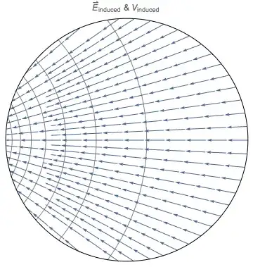

A cute side-effect of this phenomenon (credit to Bob Geroch for posing a similar problem to me years ago) is the following: Suppose we could somehow freeze the induced surface charge in place on the sphere, and then remove the point charge. The electric field inside the sphere would then look exactly like there was a negative point charge at the same location outside the sphere, like an "electric afterimage". The equipotentials inside the sphere would be concentric arcs, centered at a point outside the sphere:
(Apologies for the clunky field line diagram; Mathematica is not well-adapted to making field line diagrams. The field lines do not, of course, end anywhere except at the surface of the sphere.)
