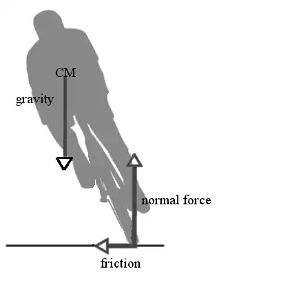

Alright I'll throw my hat into the ring with an answer. The idea that it's an unsolved problem is totally bogus.
When you start to fall to one side or another if you turn the wheel slightly in the direction you're falling the bicycle starts to follow a curved path. There is a force due to friction that deflects the rider's path into a curve:
friction bike turn
The frictional force pushes against the base of the bike and acts to stand the bike back up vertically. The inward directed friction is what is providing the centripetal acceleration.
This answer becomes obvious when you ask yourself questions like:
  • What happens if you are riding quickly when you cross a long patch of ice? The answer is that you slip and fall and no gyroscopic force of the wheels or anything else prevents this.
  • What happens if you ride quickly through loose sand? The answer is that if you try to turn (lean) even a little bit too much the sand flows under the bike wheel and doesn't provide enough friction to keep the bike up. You fall over.
  • If you want to lean more in a turn do you need to go faster or slower? The answer is faster and it's because you need a greater inward directed force to make up for the lower normal force. The faster an object is going when it is deflected the more force is needed to deflect it which means there is more force available to fight gravity.
While searching for an image for my answer I found this source which explains it the same way: http://electron6.phys.utk.edu/101/CH4/dynamic_stability.htm
So, when you're going slowly on a bicycle the curved path you'd need to follow in order to provide enough friction to stay upright is too tight for the bicycle to turn. Without enough friction to provide the counterbalancing centripetal acceleration the bike will fall. This is also why when you're riding very slowly and trying to stay stable and upright you end up taking very sharp weaving exaggerated turns but when you're traveling quickly you go in almost a straight line. Only the very sharp turns provide enough frictional force to stand the rider back up.
