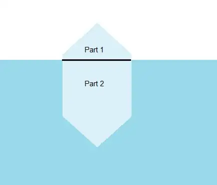

Here is an explanation that needs no explicit equations.
Consider the following diagram, in which part1 and part2 represent the ice.
The displaced water volume equals part2 volume and has as much mass as (part1+part2)
Now look at what happens when both part1 and part2 melt:
- their mass does not change, it is (part1+part2)
- it becomes water.
And we just said that part1+part2 mass water has part2 volume.
- 1,407
1You mention "The displaced water volume equals part2 volume and has as much mass as (part1+part2)". Why does the displaced water, which has
part2's volume, have as much mass aspart1 + part2? The black line that separatespart1frompart2seems to be arbitrarily drawn. – Peter Majeed May 02 '14 at 14:09 -
5The line is not arbitrary, part2 is immersed, and therefore it is the part directly responsible for displacing the water. – kalkanistovinko May 02 '14 at 14:35
1Yeah, I think I get that part. But why is the mass of the displaced water equal to the mass of
part1 + part2? That water's volume is definitely the volume ofpart2, but I'm not intuiting why it's equal to the mass of both parts. – Peter Majeed May 02 '14 at 14:44 -
10That is Archimedes' principle in application. Keep in mind that the ice density is less than that of water, therefore, a lesser amount of water is required to balance the whole ice body. – kalkanistovinko May 02 '14 at 15:21
Right - I suppose my problem is that while I understand that principle formulaically, the part of it that relates to mass isn't as intuitive by glancing at the diagram. I kinda have to assume that principle is in effect before accepting the diagram as it is. – Peter Majeed May 02 '14 at 16:07
Well, I am uncertain about what you want. Are you asking for an intuitive reasoning of the principle? – kalkanistovinko May 02 '14 at 16:24
2The whole ice block has to be balanced, so the upwards force (gravity times density of water times volume of ice) must equal downward force, which is gravity times mass of ice. Canceling gravity, we get (mass of water that part 2 occupies) = (total mass of block). – Faraz Masroor Jul 28 '15 at 01:53
"Here is an explanation that needs no explicit equations." Although I agree that a simple answer with as few equations as possible is required, I think this answer at the very least should include the equation "total weight of ice = weight of displaced water", which is necessary to justify the end result "volume after melting = volume of part 2" – Stef Aug 10 '21 at 13:30
Brandon, above, gets right to the point. Frozen water displaces its own mass in the rest of the water, which means in effect it displaces an amount equal to itself. While frozen it is larger in volume, and thus less dense, because of hydrogen bonding -- that's why it floats -- and when it melts it returns to the liquid state (surprise!) at essentially the same density as the surrounding water. A given quantity of water, temporarily larger in volume but correspondingly less dense because it has frozen, returning to the liquid state will thus not raise the overall level of water (assuming here no evaporation, mosquitoes stopping in to have a sip, etc etc) --
