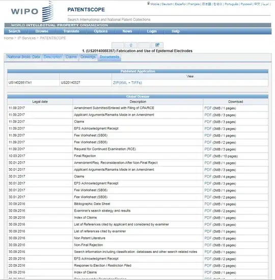

Thereafter a search on WIPO showed that they received a Final Rejection in March 2017, but they filed for Continued Examination in September, so it is still alive.
WIPO
Since it has been way over 6 months after publication or first rejection, I can no longer submit prior art to dispute this troll, right? Or is the PCT system different?
In this period after the submission window, but before the patent is rejected/granted, what else can I do, hopefully without breaking the bank? Is the process of dispute identical to that after issuance? And is this really a troll?

The claims were amended in November 2017 to read as follows: https://register.epo.org/ipApplication?documentId=5-3-US%20%20140288170RP1%20&number=US.201314028817.A
As you can see, the inventors added a mention of FPOSS to differentiate over the examiner's findings.
The examiner responded with: https://register.epo.org/ipApplication?number=US.201314028817.A&documentId=1-10-US++140288170TP1+
Essentially, additional findings were brought in to show that FPOSS is well known, and that bolting it onto the invention doesn't make the invention patentable. This kind of a song and dance is extremely common, and the application is still very much alive. It might get granted in a very restricted shape, or get abandoned, or go to appeal and be granted broadly - it's impossible to foretell.
If I am reading this correctly, the time has elapsed for submitting 3rd party information regarding this application: https://www.uspto.gov/patent/initiatives/third-party-preissuance-submissions
If this application does ever issue, you can launch a Post-Grant Review: https://www.uspto.gov/patents-application-process/appealing-patent-decisions/trials/post-grant-review
