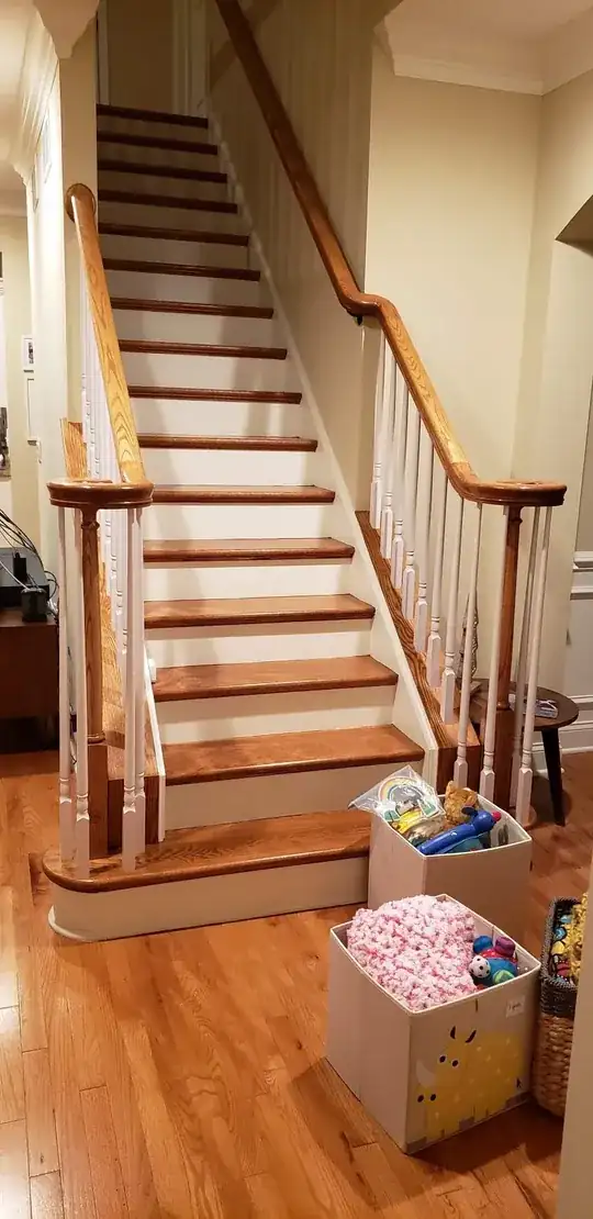

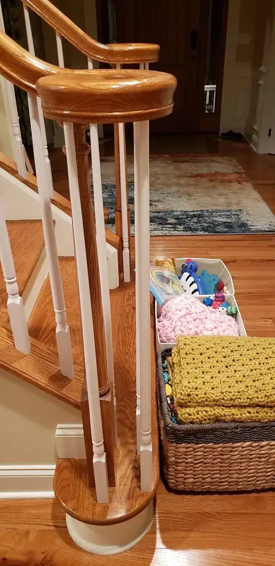

I'm struggling to figure out how to best childproof this stairway. The banisters get in the way of most every mount kit I can think of. Any creative ideas? I can of course put a gate on the 7th or 8th step but that's still quite a ways to climb and fall.

I'm no builder or carpenter, but if this were my problem, I think I would do the following. Please forgive me for not knowing the terms for one part of the staircase.
The ballusters not attached to the bottom step (steps 2 through 5) rest on a wooden base. It meets drywall near the 6th step. I would have two plywood panels cut to fit the area from base to just below the bannister and attach as securely to the ballusters as possible without ruining anything (or easily fixed with wood putty and paint.) I would then put the gate between these two plywood panels.
That would also eliminate the possibility of a child sticking their head between the ballusters (I can't tell how far apart they are, but the spacing looks farther apart than a modern crib's, which is the safest distance.)
It won't be attractive, but it will be functional, and functionality/safety trumps appearance. Put gates at both the top and the bottom of the stairs. Leave the top gate open when everyone is downstairs to minimize the hassle of opening two gates every time.

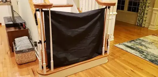

I wound up settling up a frabric-style barrier with clips. While not perfect, or attractive, it does fit perfectly.

Attach the sides of the gate to the banisters with cable ties or a conversion kit.
Your stairs and floor look a lot like mine. It has been many years since my kids were little, so I do not remember the exact brand, but we had gates that install by attaching the sides to the banisters with cable ties. So the parts that would be screwed into or pressure mounted to a wall are instead cable tied to the banister.
There are also kits that use brackets that wrap around the banister instead of the cable tie. Similar concept.
There are also kits where you attache a length of wood to the banister with a tie or clamp, and then screw the gate into that. Again, similar concept.
