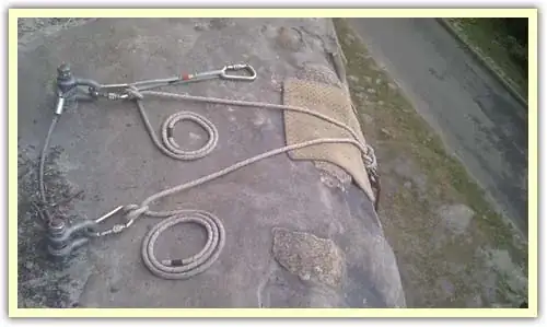

Top roping over sharp edges is never recommended, but if you insist that's what you want to do then what you want is an edge roller:
You can anchor it to the top bolts and hang it right over the edge using accessory cord so that the ropes slide over the rollers instead of the sharp edge:
The picture doesn't show it, but you're supposed to use velcro straps or something else as a safety to prevent the rope from jumping the track.
If you're concerned about your edge protector flipping over, they do make Roll modules for moving ropes that have both vertical and horizontal rollers:
There are a lot of different styles of edge protectors and edge rollers, but you can typically find them or order them at rescue supply stores.

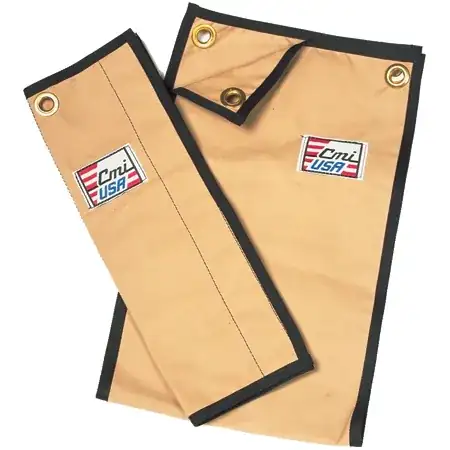

A slightly more affordable option is a rope pad:
Same idea as the rollers, but made out of heavy duty material instead of metal, and you run the ropes trough a sleeve.
