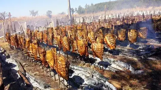

Here in Brazil, more specifically in the southern states of the country, we are used to make the weekly Churrasco.
It's basically a way of cooking meat with skewers (made of iron, but you can make it with wooden ones aswell). You pierce the meat with those bad boys and place them on top of a Churrasqueira. Inside the Churrasqueira, you have your ember and from time to time you must rotate the skewers to prevent burning the meat.
You can make an improvised Churrasqueira with either bricks, stones or with a half-cut barrel.
Churrasqueira
I don't know when the Churrasco was invented, but it's a long-time tradition of latin-american people.
Another funny fact: we have this tradition in the southern part of Brazil called Costelão (translates to big ribs for the lack of a proper word) where we gather with lots of people to eat... well, take a look:
Costelão
I assure you it tastes better than it looks :)
More informations on Wikipedia: Churrasco.
