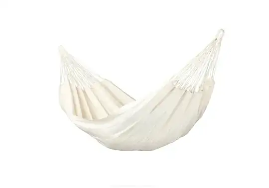

The hammock came, and it is a piece of silk with a spread of ropes on each short end. The ropes are braided together into a loop. I think this might be intended for a specialized hammock stand, but I won't have one, I'm hoping there will be a usable pair of trees in or around the campsite. It is roughly this style:
hammock type
How do I attach it to the trees? Can I use any old cord and wrap it around a tree trunk? Won't it slide down? What cord thickness do I need? Are there special knots I should learn? Is there something more convenient than a cord, e.g. some kind of short belt with clasp? (I've seen long ones for fastening kayaks to car roofs, for example). If I want to buy something for this purpose, 1) how is it called, 2) which shop has it, and 3) how do I use it?

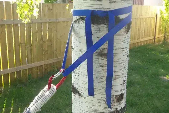

I hang my hammocks using the same slings I use for anchors while climbing, a girth hitch around the the tree is more than sufficient, but wrapping the sling around the tree twice, then tying it with a water knot is best. It holds well, it's easy to adjust the height, and it doesn't slip when weighted. The wide surface area of the webbing is better for the tree than cord too, because it doesn't cut into the tree.
You can attach the hammock directly to the anchor using carabiners if the trees are just the right distance apart, or you can use a length of cord to attach the hammock to the anchors by tying a bowline or figure eight follow through to the hammock, and a clove hitch onto a carabiner clipped to the anchor. Clove hitches are nice because they're quick to tie, and easy to adjust length.

    A faster way to set this up is to already have two loops tied on either end of your sling (just an overhand knot on a bight), clip one loop to the biner, then wrap the webbing around the tree twice before clipping into the loop on the other end. It holds just about the same, but it's quicker to set up and take down than tying and untying your knots each time. The disadvantage is it rubs on the tree more, because your attachment point doesn't self equalize, and it can slowly slip down the tree if you're rocking in you hammock. – ShemSeger May 22 '15 at 19:56
