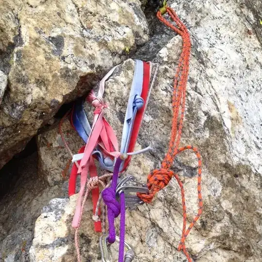

When rappel anchors pile up:

    Although inert - those belays stations would be visible from kilometers (especially the top one) and are no longer considered acceptable. Best practice is to clean them up and leave only a couple or three slings. (Add one good one and take one old one back to civilization). –  Apr 12 '15 at 05:24
    @mattnz - These examples stopped being acceptable long before these pictures were taken. In my opinion, routes that see this much traffic should have permanent rap stations bolted onto them. – ShemSeger Apr 13 '15 at 01:16
