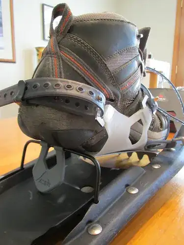

Going uphill you will be pleased most snowshoes have the heel lifter feature:
snow shoe heel lift

    Could you explain more about the heel lift? I've never seen that before, and I can't tell from the picture alone how that works. – nhinkle Jan 20 '15 at 08:38
    @nhinkle, I believe it helps when going up slopes. So you don't have to flex your ankle so much, the length of the snow shoe makes this difficult. –  Jan 20 '15 at 11:17
  • @nhinkle Liam is right. I thought it is very common from touring ski. – Wills Jan 20 '15 at 11:50
  • The heel elevators tend to take some of the work away from your calves. It makes climbing hills feel more like walking stairs. – John Walthour Jan 20 '15 at 20:08
    They're amazing is what they are. I have the MSR Lightning Ascent snowshoes-they have a very generous heel raiser on them-and it feels exactly like walking up stairs, but they're only useful on real steep climbs. – ShemSeger Jan 21 '15 at 02:23
