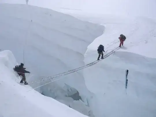

Typically such bridges are built using aluminum ladders (cf. image below) that are placed across the crevasse and fixed on both sides. In the ideal case one also builds some handrail rope to hold onto.
crevasse
As you can see from the image such bridges are rather permanent constructions, that need some material (ice screws, rope, webbing slings) to get it properly fixed. Also for a crevasse of 7.5m width you can plan for a minimum of 10m (better more) of ladder to have enough spare lengths on both sides for support and fixation. So this is nothing that you carry up the mountain just for the possibility to need it but you will have to plan ahead to bring the right material. It also requires some time to set it up, therefore such ladders are only of use on points where a crevasse is frequently crossed.

  • where was this picture taken? how insane does one have to be to cross a crevasse on alumnium ladders taped together? – njzk2 Nov 03 '15 at 22:16
  • Question: How do you get the aluminum ladder across and fixed on the other side? –  Nov 03 '15 at 19:31
    @njzk2 Well, I would guess it's from somewhere in the Himalayas and it is more or less standard for expeditions. And if you have paid some $10k to get onto the top of a famous mountain and invested lots of training, balancing over some aluminum ladders won't keep you off... – Benedikt Bauer Nov 04 '15 at 16:35
    @April you can fix the ladder sections together and lower the completed ladder bridge across using ropes. The technique is sort of a variant on a medieval castle drawbridge. Then someone crosses over the ladder bridge while belayed so they can fix the far end of the bridge. – Erik Nov 04 '15 at 19:22
