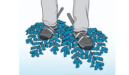

The easiest way that I know of requires you to have some kind of rope or long straps and to be near evergreen trees.
Depending on the strength of the needles and width of the trees limbs take anywhere from 1 to 4 ends of an evergreen tree limb. Be sure to use green wood so they can bend without breaking. Make each section about three times as long as your boots.
Then take the string/straps and first weave the limbs for each foot together, then weave the limbs to the bottom of your boats, making sure to weave through the boot laces so the "snowshoes" don't slip.
This will give you enough of a snowshoe to deal with powder snow. These will not however provide the kind of traction that you would get from real snowshoes with metal cleats. Not really sure how to replicate that feature.
Backpacker.com has this same idea on their site with sketches here.
