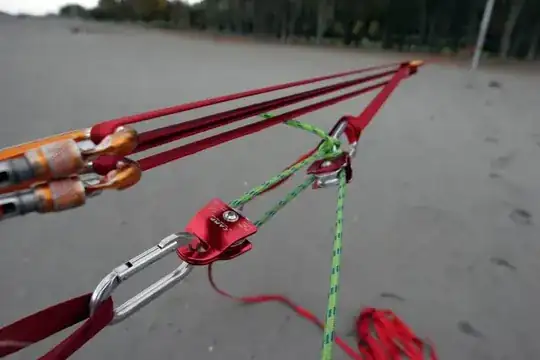

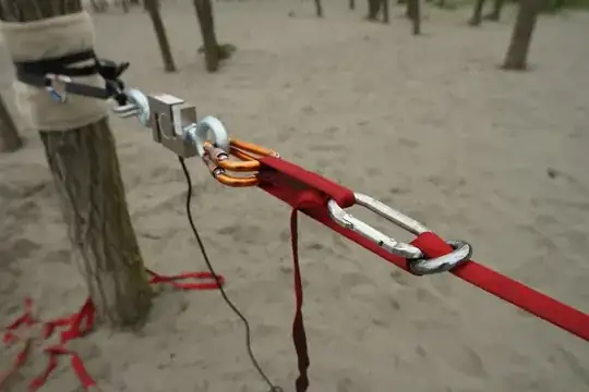

I cannot recall seeing an anchor/tensioning system using only carabiners but the line-locker system using a forged rappel ring is simple, light and inexpensive. Chain links are even less expensive but need to be deburred to protect your webbing. One of his basic tensioning systems looks like this (the load cell is only for testing of course):
Further illustration and efficiency testing (video).

    +1 I used those same videos to learn my "primitive" setup. With just carabiners it is easy, you just have to tie it off where you would use the line lockers. Having said that, the line-lockers are very cheap and really worth it, they make it easy to untie, decrease the wear on the slackline and makes it look more elegant :) – yarian Nov 12 '12 at 04:00
  • @yarian thanks for the vote. I guess that's what Adam was showing at the beginning of the "Using line lockers" video but an actual setup using that method was not shown (that I have seen). – Mr.Wizard Nov 12 '12 at 16:30
  • Most primitive setups do not use double carabiners like in the photo above. Also, the pulleys are not necessary for shorter slacklines rigged in this way. And regarding the forged ring; you can actually use a carabiner instead of the ring too. Although it will be much bulkier, and might be bad for your webbing. – Adrian Schmidt Jan 30 '14 at 21:22

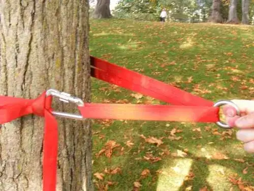

You have probably already seen the excellent resource at www.slackline.com but they have an excellent page on how to tie your slackline to a tree using ordinary webbing and carabiners.
Key image from their sequence:
Then just add a carabiner (with webbing wrapped round it to protect) to the metal ring and you are set.

  • This addresses making an anchor, but not tying a slackline. Updated the question to make it a little more clear. (Also, I don't have a metal ring.) – Lost Nov 04 '12 at 18:38
