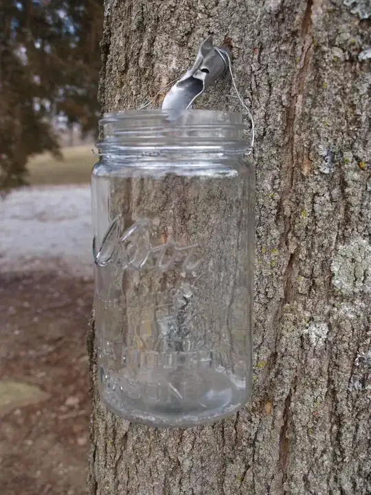

I highly recommend maple syrup during the spring and fall seasons when it can naturally be harvested. Relevantly you will need to process it by reducing a large amount, and the extraction may take some time, but it requires little more than finding a few trees and a few mason jars and taps.
you can heat the very same jar in a fire to bring it to a boil. The Maple sap should be at about 185°F (85°C). Never let it go over 200°F (93°C) unless you want to make candy. The amount of sap you have to Syrup is a 40 to 1 ratio, meaning for 40 jars of sap, you get a single jar of syrup. OR a single jar of sap can produce a few tea spoons. At 52 calories per a tsps that's actually pretty significant.
However, sustained stranded in the woods for several days, this calorie-dense substance shouldn't be ignored as it can be harvested reliably seasonally and in volume in a forest. Taps can be produced from wood, and a simple knife can tap a tree enough for sap to start to flow.
If you managed to tap 5 jars on 5 trees you would fill them in about 2-3 days. This would produce nearly a quarter jar of warm thin maple syrup. Not a bad thing to have after being stuck waiting for help for a few days.
  • I'm not sure why you'd need to concentrate it for short term survival, or at least not so much. You need water too and the sap is a good source. For seasonal storage of course you do. But that would need a lot of containers which seems unlikely – Chris H Jul 12 '22 at 18:07
