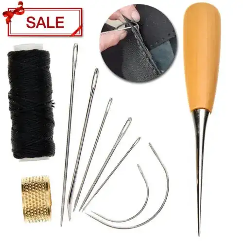

  • It is a good idea to have an awl and some dental floss to sew the sole to the shoe before gluing. Especially the rounded needles came in very handy. (search on ebay for "canvas repair stitcher").Awl
