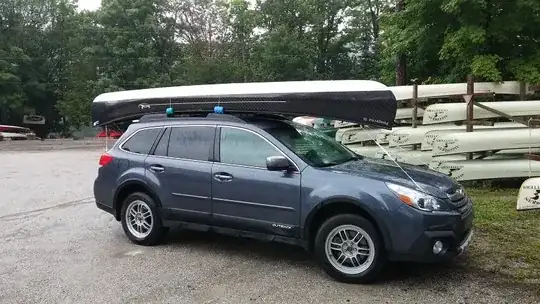

    This is how I have always done it. Those mid straps are always heavy duty rubber bungies, and in the front i run a rope from the bow tie off point on the canoe around both corners of the bumper to keep it from twisting. I have never had a canoe move on me. I suppose you could also use ratchet tie down strapos in the middle as well. – jmarkmurphy Aug 03 '18 at 12:56

Position the canoe centered between your cross bars. You can use foam padding (e.g. pool noodle) between the crossbars and gunwales if you want to protect your gunwales. With stout cordage using a truckers hitch knot or Cam Straps, tie the canoe to the cross bars. Tie the bow and stern to the outside corners of the vehicle. This prevents the canoe from rotating from a crosswind.
