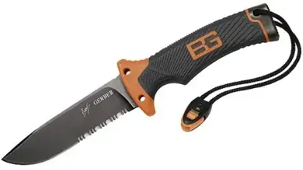

If your plans depends more heavily on your knife, you will have to accept a little extra weight for a longer blade. Your best bet there will be the Gerber Bear Grylls-model survival knife ($40 and 11 ounces). Whistle and fire starter are built into the knife.

  • Have you ever tried to use the ToolLogic as a survival knife? I did, and due to its lightweight, not ro say cheap built, found it as useful for the tasks of building a shelter or splitting wood as a splitting axe for food prepping. I found the blade to be as sturdy as butterfly wings, resulting in powercuts to be more a leap of faith than a controlled and secure operation. Plus, both the rod and the light are mediocre at best - too many compromises were made to pack everything together. All in all, the ToolLogic is as good as a survival knife as your average nail clipper is. – Markus W Mahlberg Jan 30 '17 at 07:41
  • @MarkusWMahlberg I have not used the ToolLogic SL3 for splitting wood, as it is not a heavy enough knife for that. I have split wood happily with the Bear Grills knife listed above. Again, the more you want to depend on your knife, the heavier it is going to have to be. If you 100% expect to depend on your knife, you will need to sacrifice more weight and get something like the Bear Grills thing. The ToolLogic SL3 is for backpackers who carry a tent with them and don't build fires (which is a lot of people, so it has a solid use-case market). – john_science Jan 30 '17 at 15:48
  • Well, that is exactly my point - you listed the ToolLogic under Survival Utility, and from my perspective, as it fails to be a reliable knife for the tasks at hand when in a survival situation, I can safely say that it has little to no value in that regard. Other than that it is still better than having no knife with you at all, of course. – Markus W Mahlberg Jan 30 '17 at 16:09
  • @MarkusWMahlberg I say the SL3 is "the best compromise between utility and weight", but "If your plans depends more heavily on your knife" get the Gerber model. How would you suggest changing that wording to make it more clear? Also, just to be clear, this post is about "Backpacking Knives". And rarely do people backpacking need to build a shelter or a fire. "Backpacking" means carrying a tent, sleeping bag, and other things with you. The SL3 is good for this, but it sounds like what you want is a knife for a fully survival situation, which was not OPs question. – john_science Jan 30 '17 at 16:14
