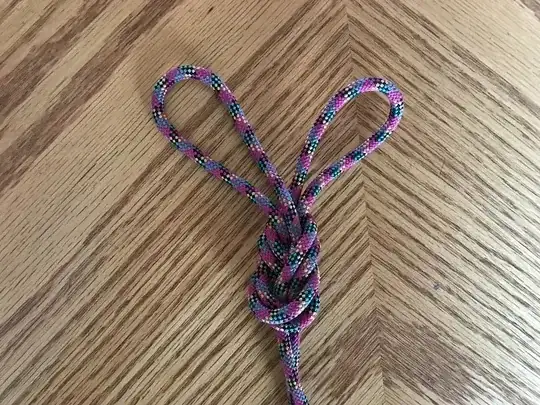

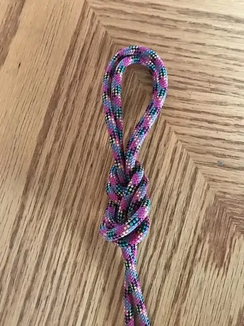

This one is almost identical to the figure eight on a bight, with one crucial difference.
When you get to the final step of the figure eight on a bight, instead of pushing the end of the bight through the loop you take another bight of the bight and push that through the loop, then flip the end of the first bight over the top.
Just like so,
Like this
Finally, if you were going to use this for an anchor you would clip one carabiner through each of the loops. This is also why some people refer to it as a bunny ears knot.
This knot works really well when fixing a rope to a two bolt anchor, and is easier to untie than a regular figure eight after being weighted.

See: Double Figure 8 Loop ("Bunny Ears")
The Double figure eight is tied like a figure eight on a bight, except instead of finishing the knot by pulling the bight through the loop, fold your bight into a second bight, pull the second bight part way through the loop, then loop the end of your first bight over the whole knot to finish it off.

  • Importantly, you can also make one loop very large and one very small, and link them with a karabiner. Then you attach the two sides of the large loop to two anchors. The karabiner allows the knot to slide from one side to the other to self-equalize the loads on the anchors as a climber moves to either side (as the route might require). Do note that the two loops depend on one another - if one fails (eg is cut through), they both fail. They do NOT provide redundancy of anchoring – AdamV Dec 03 '18 at 15:14
