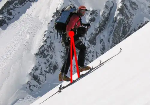

On the right snow, you can ascend extremely steep (even if it probably isn't the most economical thing to do) - so from that aspect, I don't see a problem.
Looking at the skiers center of gravity, it doesn't seem to be off by far either. I estimated the center of gravity at the red dot. If the weight was mainly on the back leg, the current orientation would make sense (vertical red line). However the picture is shot in the moment before the left/back leg is pulled to the front (it is almost stretched, right/front foot rests on "climbing assistance post" (German Steighilfe)), so most of the weight will be on the front leg. There is an ongoing front motion, so being slightly behind the front leg might be fine, but not that much. In conclusion I would estimate the angled red line to be vertical.

    I would add that the straps hanging down from the backpack look vertical, or at least parallel to the picture's left and right sides, unless they were photoshopped in as well. – Techie_Gus Feb 23 '18 at 14:54
  • @Techie_Gus If the straps are hanging vertical, then the slope is even steeper than the picture shows. – ShemSeger Feb 23 '18 at 18:25
    @ShemSeger Giving it a second thought, I think the straps can't be used as a good reference for rotation as they will be swaying with the movement and the picture froze them during their oscillation. – Techie_Gus Feb 23 '18 at 18:44

I agree that the mountains in the background look weird, but the crop is so close that it's hard to tell for certain without additional context.
This image appears to be from an article on skinning up steep slopes, and states that the skier is on a 34 degree slope: http://straightchuter.com/steep-skinning-technique/
Given that Chris Figenshau appears to be a very experienced skier and guide and also that a quick check with the ruler tool in photoshop gets a pretty similar number: Measuring the angle of the ski on the slop in photoshop
I'd say it's legit.

    The article might state that the slope is 34° because that's what the image had been altered to imply. The linked description in the article is not independent corroboration. – Andrew Leach Feb 24 '18 at 10:23
It cannot be that the image is rotated, and that this rotation is the only alteration to the image.
The reason is simple: look at the straps of the backpack. They are hanging vertically, and they are aligned with the vertical axis of the image.
Essentially, they give us a "plumb line".
If the image had been rotated, that detail would have to have been doctored also to conceal the ruse.

  • there had been a headwind (somehow not shielded by the climber's body) which tilted the straps by a few degrees, allowing for the rotation to make them appear vertical.
  • the photo was snapped just as the climber made a forward lurch. A momentary forward lurch would not only tilt the hanging backpack straps, but also foil the analysis of the body posture and center of gravity and all that. In general, what we see as a static situation in a still picture may in fact be an illusion created by taking a snapshot of a momentary dynamic situation.
Other than the straps, another detail we can look at in the image is the pattern of of snow accumulation on the crags in the background. I've enhanced the contrast over the lower left area:
There is a pattern of cascading trails in the accumulated snow left behind by sliding powder suggesting that the picture is upright. The inset duplicate of that detail indicates with red lines what I'm referring to.
Kaz
  • 219
    Straps dangle as you move. They are not a reliable plumb line on a single still. – Lightness Races in Orbit Feb 24 '18 at 16:46
  • The situation is absolutely dynamic: the claim is that the guy is moving up the slope! – David Richerby Feb 24 '18 at 19:19
    The straps are of differing lengths, so it would be extremely unlikely to catch them at so close to the same angle during a "lurch" - they'd tend to swing at different rates if they were doing so continually, and one would move further than the other if it was a one-off movement. Couple that with the snow in the background ... – Will Crawford Feb 25 '18 at 01:53
    ... and, on reflection, he's probably static to pose for the photo(!). There is probably no way to confirm or deny this, as the short exposure (look how bright the background is) means no detectable motion blur. – Will Crawford Feb 25 '18 at 03:01

As mentioned above, the straps seem like a pretty good indicator that the picture is real. Even if he was moving, skining up a slope is a pretty smooth movement that wouldn't disturb the straps much. If there was any wind then there is a low chance that the two straps would be parallel with each other.
Posing for a picture like this would be pretty easy. Given grippy snow conditions, you could skin up an entire mountain at that angle. Many people I know (including myself) prefer a steep skin track because it makes the Elevation Gain/Distance Traveled ratio higher. Although I think it is technically more energy efficient to be at less of an angle.
Seeing as this was posted to an article specificaly about steep skining, and the ease of taking such picture. I would say there isn't any motivation to fake it.

The picture in the answer to that question you referred to here doesn't have a source listed for attribution. To me, however, it does look like the same picture as the one in the answer to the question that ShemSeger suggested as a duplicate.
That answer attributes the picture to a site called Straightchuter, which gives the name of the person who made this climb and the technique, called Steep Skinning, needed to do it. If indeed that is the same picture, then the picture you have would not have been altered.
It's a photo of
Chris Figenshau skinning up a 34-degree icy slope in New Zealand with textbook perfect style.
These are the instructions he offers in order to make this climb.
