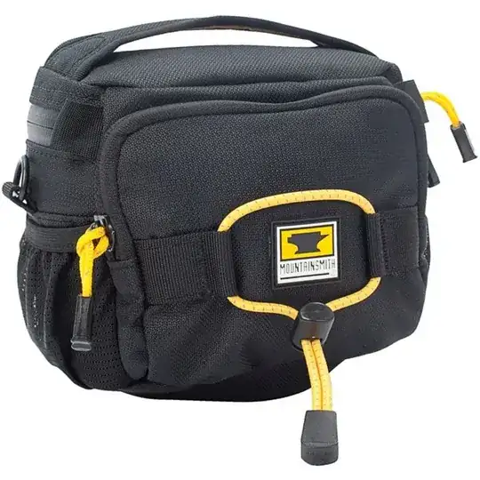

We use a padded bag that goes around the waist like the dreaded fanny pack. It's handy to keep snacks, first aid kit, and so on in, as well as the camera. Here's the sort of thing I'm thinking of, though it's not the one we use:
http://www.mec.ca/AST/ShopMEC/Packs/CameraBags/PRD~5027-259/mountainsmith-tour-fx-camera-bag.jsp
You might keep spare batteries in a shirt pocket under your coat and swap them back and forth as needed. But in my experience temperatures below zero celsius are not particularly hard on batteries. I take no special precautions in Ontario winter unless it's below -20C.

  • Thanks Kate, it's good to know my batteries might be okay after all. Can you comment on the compatibility of using a waist bag like this in conjunction with a backpack? The waist bag on its own would not have sufficient capacity to hold my tent, food, sleeping bag, etc. – D.H. Jun 13 '12 at 13:44

  • @D.H. wear it facing forward - easy to get to whether you have a backpack on or not. Then whether you're full on hiking with tent and food, or just out for a few hours, the camera and such are always in the same place. – Kate Gregory Jun 13 '12 at 17:53
  • @KateGregory Thanks Kate. That confirms the ease of access to the camera, which was a really important factor in my question. I guess the only point remaining to be confirmed is whether one can wear such a waist bag at the same time as a large backpack when that backpack is strapped to the hips. I assume the waist bag and its strap go above the backpack strap, between chest and hip level? – D.H. Jun 14 '12 at 09:45

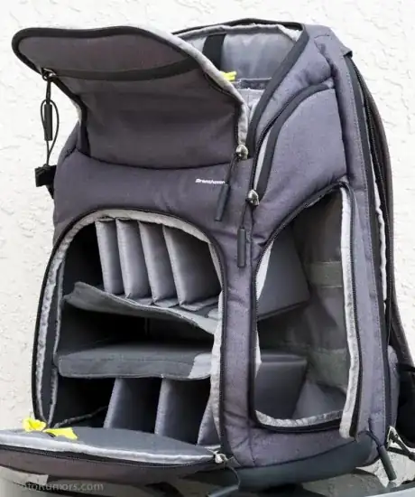

There are camera bags looking like the picture below. This one is quite big, there are also smaller ones.
The benefits are:
  • It has lots of small compartments, so you can put your lenses and accessories sorted
  • Or you can add non camera related items within the same bag.
  • It has multiple openings, so you can access it easily
  • Most you can drag in two ways by easily 'swing' the backpack over:
    1. On your back (normal), when you don't use the camera for some time.
    2. Aside of you, in this case you can take the camera easy out of the backpack (and put it back) … you can even put the camera back without closing the bag without risk of falling out of the bag).

  • The question relates to hiking. If I have this camera bag on my back, where do I put my tent and sleeping bag? – D.H. Dec 13 '19 at 05:42
