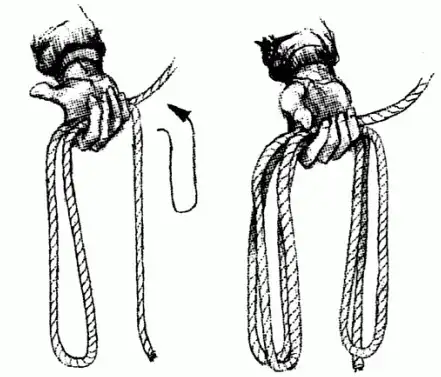

The first two images on this site (pictured below) show how you can pack your rope without producing tangles. Note that the final knot that fixes everything does not really matter with respect to tangles.
Packing the rope tangle-free
The important part is to not pick up the rope in closed rings as every ring will introduce a twist of the rope into the same direction.
Instead pick it up as loops hanging alternatively right and left from your hand. This way the twist in the rope from one loop is cancelled out by a twist in the opposite direction from the next loop, meaning that you will end up with (almost) zero twist at the end. In the "closed ring" approach you would introduce a lot more twist instead as the twists sum up positively at the end.
