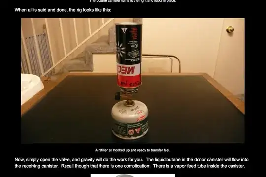

A third option to Russell Steen's excellent two is:
To Refill:
There are adapters (from G-Works and Alva, amongst others) that will let you refill them using either other butane canisters, larger 16oz propane canisters, as well as the small aerosol-cans of butane that you can get at Asian markets. Adventures in Stoving has a nice article of refilling canisters using the adapter setup pictured below:
Canister filling up
Fine print: There are of course many caveats to refilling canisters that weren't designed to be refilled. Your mileage may vary. Do not store refilled canisters in enclosed spaces with ignition sources. Do not smoke while refilling canisters. Do not allow moisture to get into your canister. Do not refill canisters that appear damaged. If it blows up or leaks, it's your fault. etc. etc.
