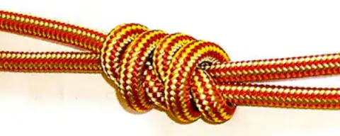

The double, triple, ..., $n$-ple fisherman's knot
Now, keeping in mind people have used both of those knots in climbing for the last century, it's hard for me to believe they aren't safe. I've read that the impact of a hard fall would be enough to "melt" something and then bla bla, but I didn't find any evidence of that on the web. In fact, I think it might be possible to prove that this sentence cannot be true. I have some gear that I have re-slinged with the water knot and it has been catching me every day (this doesn't mean it works, I just might have been lucky 200 times in a row).
