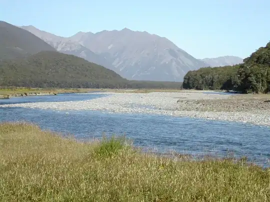

New Zealand has many tracks with river crossings, and it is known that rivers can be deadly if approached without respect. With that in mind, always check out what is down stream for if things go pear-shaped - avoid sieves (branches which you get washed into and held under) as well as rapids.
Stability wise, you would have the following ranking:
  1. Boots, laced up well
  2. Sandels
  3. Bare feet
  4. crocs or jandels or similar. I am joking. Just don't. Crocs have the holes in them to allow the last shred of your dignity to escape.
Comfort wise, if your boots get wet, then they get a bit heavy. As long as you can dry your feet out in the evening, and have dry socks to start each day, you can last a while with boots getting wet. If they are leather and you have few crossings, you can wring your socks out after each crossing, but I usually don't bother.
I often use sandals, and they are also handy for having around the camp site in the evening, instead of my big clod-hoppers - though sand flies do make a meal of the ankles where I come from.
I only cross bare feet if it is a sand or shingle base, as I can't afford to slip and wreck my ankle, or get a deep cut filled with mud. Your feet are your life.
If you do decide to remove your boots to cross, do it properly, and TIE them to your pack or belt or something, using the laces. If your boots are just tied to each other and looped around your neck, and you fall over - they are gone.
Use a stout stick about your own height, as a third leg, keeping it upstream. It allows you to maintain two points of contact to the riverbed.NZ River This is a pretty typical South Island river. It might be the Hawden valley just below sudden valley, or possibly the doubtful valley, but I honestly can't remember when I took it.
