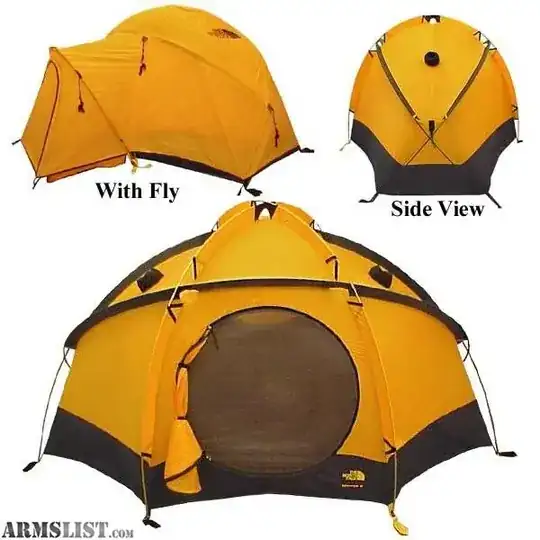

That's essentially how 4 season tents work, the tent is full nylon (no mesh) and the fly is full and basically acts as a second tent, creating that air gap. some 4 season tents even have little foamies on them that help keep the gap, preventing snow from squishing the fly against the tent and eliminating that insulating volume:
Putting a tent inside another tent would work, but it would work better if the tents were closer in size, then you wouldn't have a large of a volume of air to try and warm.
