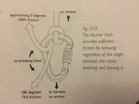

The following illustration is from the climbing and mountaineering bible Freedom of the Hills, which by the way every aspiring climber should have in his or her bookshelf.
illustration of a Munter hitch taken from Freedom of the Hills

    The picture also shows the weighted end next to the gate. I have never seen a "knot" with so much disagreement. – StrongBad Mar 02 '16 at 12:02
  • I have had it confirmed by three professional instructors (two in person, one in a video online) that 0 degrees is the strongest braking position. Of course that's not actually an independent confirmation, because they're probably all getting their information from Freedom of the Hills. –  Mar 02 '16 at 15:40
    @BenCrowell I am pretty sure physics supports the claim that the 0 degree position has extra holding power since it has an extra bend. It would be nice if there was a reference with actual measurements. – StrongBad Mar 02 '16 at 15:47
  • Yes, I agree that it's physically plausible. We expect tension to go like exp(mu theta) as a rope is wrapped around a cylinder, so here we should get an extra factor of exp(pi mu). The nylon sheath of a climbing rope on an aluminum carabiner probably has mu of approximately 0.15. (It's not easy to measure accurately or reproducibly.) This gives exp(pi mu)~1.6, which seems roughly consistent with the diagram from FotH claiming 4/3, as well as with requiem's data. (A mu of 0.1 reproduces those numbers better.) –  Mar 02 '16 at 20:35
