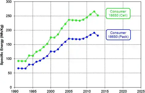

Things are getting better (but very slowly)
Lithium-ion technology has been on the market since 1991, with variable but fairly continuous improvements from one year to the next. Energy density tends to increase, on average, by a few percent per year. This makes for significant improvements in the long term: as the graph below from Masias et al. (2013) shows, energy density of the common 18650 battery cell improved by a factor of more than 2.5 between 1991 and 2013:
Figure: Energy density trends
Similar trends can be seen in the data of Jeong et al. (2011) and Pistoia (2014).
We can probably expect these marginal improvements to continue at least for a few years more (Tesla seem fairly confident about it, for instance). So our 2.4 kg weekend water-boiler will probably come down below 2 kg in the foreseeable future, but beyond that it's hard to say. Even if lithium-ion energy density could continue to improve indefinitely at 10% per year, it would take over two decades to catch up with ethanol. Would-be electric hikers might do better to pin their hopes on the development of some entirely new battery design. There are plenty of research groups working on potentially revolutionary new battery technologies, but potentially is the key word here: very few bright ideas survive the long journey from notebook to laboratory to factory.
