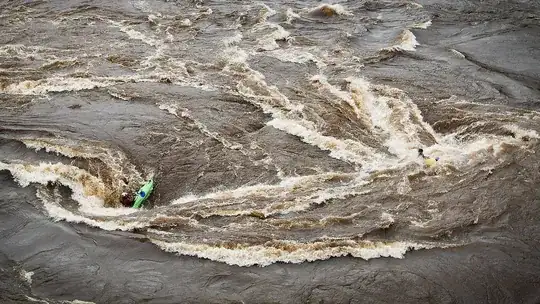

Yes, you can survive it... if you've got the skills. Not many years ago I watched a film at a mountain film festival, and it was about the first guys to ever kayak the Congo River. They weren't only the first people to kayak the river, they were also the first people to navigate it-and survive.
Here's a clip from National Geographic: https://www.youtube.com/watch?v=HeZjJk2lTHs You basically just do your best to stay upright, point your nose out, lean forward, and paddle like crazy to either try to escape it, or ride it out.
