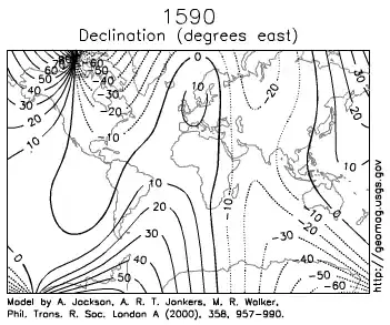

This map (and the Wikipedia article) will explain why you don't have a problem (in the UK, I'm guessing), but others do, elsewhere.
In the UK, you can ignore it at the moment, but you need to understand WHY you're ignoring it :)
As an aside, compare this with the declination in 1872... Then, the declination error in the UK would have been between 20 and 30 degrees west!
Typically when walking on a bearing you need to allow a margin of error of about 5°. (ie, when 'aiming off', allow at least 5° of error). So the sub-one degree at present in (most of) the UK isn't a big issue.

  • nice drawing, but I don't really understand what the lines mean? –  Dec 17 '15 at 13:23
    It's a map showing the magnetic declination around the world. If you're on the "-10" line, your compass will point 10 degrees off true north. The UK is close to the zero line, but parts of Canada, for example are over 20 degrees off. – Roddy Dec 17 '15 at 13:28
    Ah ok, very interesting. What's the "point" below Australia? –  Dec 17 '15 at 13:30
    I like this, I'll drop you a bounty I think. I've never seen this map before –  Dec 17 '15 at 13:33
    Cheers :) It's the South Magnetic Pole. https://en.wikipedia.org/wiki/South_Magnetic_Pole. The North one is off the top of the map somewhere. – Roddy Dec 17 '15 at 13:41
