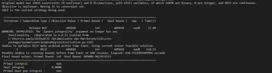

This is what the solver has to say, but I don't really know how to interpret this. In my data, $N = 4831$. Output Solver

  • Thanks! I used the Ipopt as the nonlinear solver, but still the same results. Do you have any other pointers I can take a look at? If I restrict $N=10$, it works fine. So it seems to have something to do with the magnitude of the problem. – Steven01123581321 Feb 17 '23 at 16:22
  • I don't think changing N from 10 to 11 makes the problem infeasible unless there is some other hidden errors in the indexing of the variables... – Oguz Toragay Feb 17 '23 at 17:01
  • Perhaps it is the time limit, as Rob Pratt suggested. Could that be the case? That it just takes a lot of time? – Steven01123581321 Feb 17 '23 at 17:03
  • I tried N = 20 and it has been solved immediately – Oguz Toragay Feb 17 '23 at 17:10
  • I tried the model many times with randomly generated values for s, p, and d. Even with small N (20) the model is sometimes infeasible. I could solve the model with it's current syntax up to N = 108. What are the values that you use for N, s, p, and d? – Oguz Toragay Feb 17 '23 at 17:26
    Yes, it seems to be hard when $N$ grows larger and it depends a lot on the values in it I see. I'll accept the answer, because it the implementation seems correct as you showed. – Steven01123581321 Feb 17 '23 at 17:44
