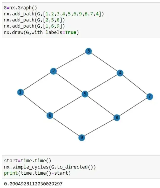

With Johnson's algorithm from the networkx library, all 13 cycles are found in 0.0005 seconds:
Kuifje
  • 13,324
