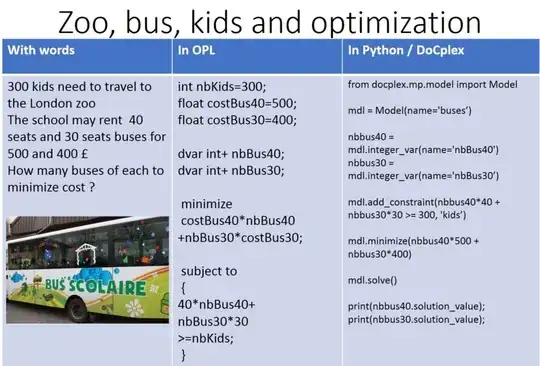

You may use an Algebraic Modeling Language like AMPL or OPL or GAMS or you may choose a GPL General Programming Language like C++ or python.
I discussed pros and cons at
Optimization (aka prescriptive analytics) : Should we write the model in a modeling language or a general programming language ?
To see this on a small example
All options have advantages and issues.
My favourite language to deal with OR problems : OPL that is linked to CPLEX Second choice : python docplex

    Wow, so if I am getting this right, in this modeling language you have to hard-code the size of vector variables into the name of the variable? How would you ever integrate this into a production pipeline where the size of the array isn't known into runtime? Thank god for Pyomo, JuMP, etc... – Max Aug 13 '23 at 01:55
