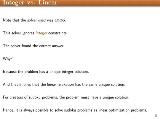

I was reading through the following notes regarding solving a 9x9 Sudoku via a binary integer program
https://vanderbei.princeton.edu/tex/talks/INFORMS_19/Sudoku.pdf
The formulation is straightforward but on slide 10 the author claims that if the problem has a unique integer solution then that implies the linear relaxation has the same solution and therefore the binary constraints on the variables is unnecessary.
It's really not clear to me why this would be so. Wouldn't this contradict the fact that Sudoku is known to be NP-complete?

  • No, its the other way around. It means that in this specific case, the sudoku is no longer NP-hard. – Kuifje Oct 06 '22 at 10:06
  • @Kuifje Are you sure it is referring to this specific case? The last sentence on the slide is "Hence, it is always possible to solve sudoku problems as linear optimization problems" - that seems like a very general statement. – Ram Oct 06 '22 at 10:14
    I have found Provan (2009) where they say that if the solution of the Sudoku can be found via pigeon-hole rules (i.e. enough non-empty cells are given), then the relaxation solution is integer (Theorem 2). In general, it is NP-complete by reduction to graph colouring or set covering. The claim on unique integer solutions in this talk sounds wrong (otherwise all MIPs with unique integer solutions would be easy peasy). – David Torres Oct 11 '22 at 11:15

The creators of the Sudoku puzzles ensure players that there is a unique solution to the puzzle. Hence, the system of integer linear equalities over Boolean variables described in Vanderbei's slides has one and only one solution. This is what Vanderbei calls the "unique integer solution" in slide 10.
EDIT: THE FOLLOWING ARGUMENT IS FALSE BECAUSE THE RANK OF THE MATRIX IS NOT (NECESSARILY) FULL. SORRY FOR THIS WRONG PATH. SEE THE DISCUSSION IN THE COMMENT. Now, consider a relaxation of this system of equalities over the reals. This is what Vanderbei calls "linear relaxation" in slide 10. The unique integer solution discussed above remains a solution to this relaxed system. A system of linear equalities over the reals has no solution, one solution, or an infinite number of solutions (for a proof of this claim, or at least an intuition, please check a linear algebra course on the web). Consequently, the linear relaxation has one solution which is the integer one.
In the case where the initial assertion becomes false - "the creators of the Sudoku puzzles ensure players that there is a unique solution to the puzzle" - then the property above does not hold anymore.
Then, to answer your question, the best is to cite David Eppstein, a renowned computational complexity theorist, who blogged a lot about the complexity of the Sudoku puzzle in the past:
"In the meantime, when one says Sudoku is NP-complete, one should keep in mind that this refers only to an unusual type of Sudoku puzzle in which there might be multiple solutions."
To conclude, may we recall that any KxK Sodoku puzzle with K a fixed parameter in input, that is, with K a constant, is solvable in constant time.
