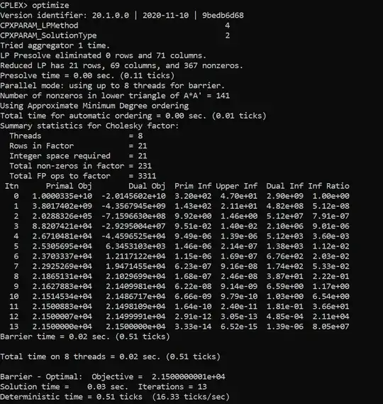

To use the barrier algorithm without crossover with cplex 20.1, you can use the following options:

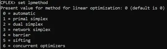

  • set lpmethod 4 (this selects the barrier algorithm): enter image description here
  • set solutiontype 2 (this deactivates crossover): enter image description here
The log looks like this: enter image description here

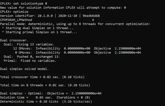

You can see the barrier algorithm is indeed used. If you activate crossover, you can view some additional information: enter image description here

If you are using the interactive optimizer, you need to type "set barrier crossover" (or just "set barrier" to get a list of available parameters related to the barrier method). When you type "set" to get a list of parameters, "barrier" refers to a submenu, not a single parameter. (Note the explanation: "set parameters for barrier optimization".)
