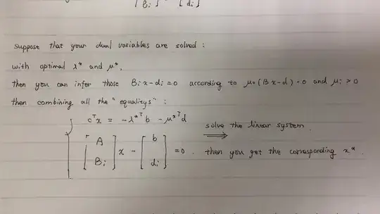

an intuitive transformation
I'm also interested in this problem. I think the transformation between the dual solution and the primal solution must be related to KKT conditions, so I give my intuitive solution.
If in primal problem the variable $\mathbf x$ was a vector of dimension $n$ and constraints were made of $m+p$ equations, in dual problem we should have $n$ equations in $m+p$ variables. It is common practice to solve the dual problem especially when its resolution is easier and quicker than the primary problem: it is the case when $ m+p > n $ and Rocuhe-Capelli theorem holds so that there are more than one single solution.
At the optimum, the equality of the values of the objective functions in primal and dual problems holds, so that it is possible to evaluate the quality of an admissible point in the primal problem without having to solve the last one exactly.
In order to assess the goodness of an admissible point under examination $\mathbf x'$ we can simply compare the value $f(\mathbf x')=\sum_{i=1}^n c_i x'_i $ with $f(\mathbf x^*)$, where $f(\mathbf x^*)$ is equal to the optimal value of the objective function of the dual: $f(\mathbf x^*)=h(\mathbf y^*)$.
In a minimum cost problem if it turns out that $ 0 < f(\mathbf x') - f(\mathbf x^*) \leq \varepsilon $, then we could be content with approximating $\mathbf x^*$ with $\mathbf x'$ confident in the fact that the additional cost to be incurred for choosing a sub-optimal solution $\mathbf x'$ is certainly not greater than $\varepsilon$
