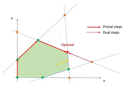

In the figure below, the primal simplex iterations are the full arrows, the dual simplex iterations are the dotted arrows. The green dots are the feasible bases, the orange ones are the infeasible bases. The yellow arrow represents the gradient of the objective function (the best direction). You can see the the primal steps remains within the polygon, while the dual steps starts outside of the polygon.
The benefit of using the dual is that sometimes, it is easier to "fix" an infeasible solution close to optimality, as in the figure below, only one step is required.
