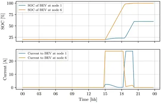

Now when I start the optimizer without the equal-SOCs-constraint activated, I get the following result:
The optimizer clearly favors the BEV at node 6, which is not fair.

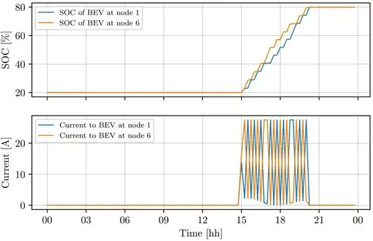

Now when I activate the equal-SOCs-constraint ($\Delta SOC_\mathrm{max}=0$) and rerun, I get the following result:
Okay, both end up with the same SOC, that's nice. But the optimizer switches the chargers on and off all the time -- that's annoying and also not good for the batteries I guess.

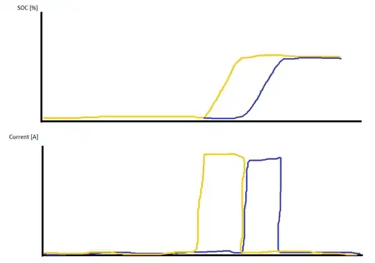

Is there any other way to formulate the equal-SOCs-constraint, to achieve a smooth loading? E.g. something like (sorry for my bad drawing):

Regarding the equal-SOC constraint, you might want to consider changing $n-1$ to $n'$ and enforcing it for all pairs $n,\ n' \in \mathcal{N}_\mathrm{BEV}$ such that $n' < n.$ This would add some constraints but perhaps make for a more "egalitarian" final state. As it stands, when there are more than two charging stations the solver can leave you with an ascending sequence of SOCs, with the first charging node at a considerably lower level than the last one.
As far as the variability in current, one possibility would be to add a constraint saying that $I^\mathrm{BEV}_{t,n} - I^\mathrm{BEV}_{t-1,n}\ge \lambda$ for some parameter value $\lambda > 0.$ This limits the amount the current can drop over consecutive periods, and keeps your model as a linear program. An alternative approach would be to assert a minimum number of periods that current could be supplied. For instance, you could say that once charging is turned on it must continue for at least 3 periods. This approach would require binary variables for each combination of charging node and time period, plus additional constraints. It would turn your linear program into an mixed integer linear program.

  • yes, I have also thought about a similar constraint with the currents. But I think this cannot be my solution :(. One important thing is the possibility of the optimizer to shift the charging of the BEVs when it realizes high loads from the households. This approach might make the optimizer "too slow" to react fast enough on changes in the household loads. But still thanks for the tip! – Andre Apr 18 '22 at 08:52
    Since household load is a parameter, you could try a constraint along the following lines: $$I_{t,n}^{\mathrm{BEV}}\ge \lambda I_{t-1,n}^{\mathrm{BEV}}-\max(0,I_{t,n}^{\mathrm{HH}}-I_{t-1,n}^{\mathrm{HH}}).$$If household load at the node decreases or stays the same, charging current can go down by at most a factor of $1-\lambda.$ If household load increases, charging current can go down to match the household increase plus a fraction $1-\lambda$ of the previous charging current. – prubin Apr 18 '22 at 14:51
