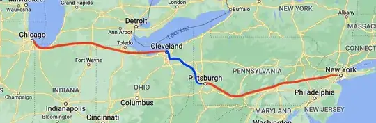

My goal is to bundle pairs of loads that increase my truck's paid miles. I normally have a set destination and origin. Let's say I'm going from NYC to CHICAGO. Then I search on the trip database for loads that need to be delivered along that route. Imagine I find one with a pickup in Pittsburg and delivery in Cleveland. Then my paid miles would be the driving distance from Pittsburg to Cleveland. But I'm not getting paid for getting from NYC to Pittsburg or from Cleveland to Chicago. A picture is better for explaining:
In blue you can see the paid miles and red the not paid miles. If I could find another load from NYC to Pittsburgh it would be great or Cleveland-Chicago as well.
Now the question is how can I algorithmically find pairs of loads that go well together given a route? I know my start and end of the trip. I just need to go through the list of trips to find the best ones for me.
-Going well together is a loose definition. Generally speaking increasing the % of paid miles is the goal.
