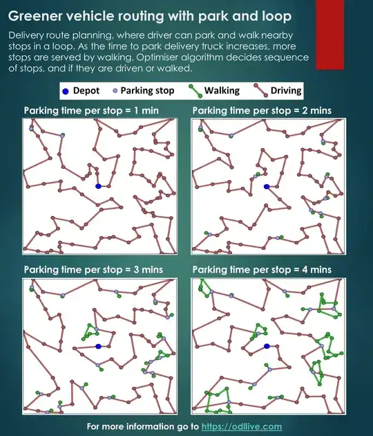

You can actually get good results by dealing with it relatively simply. We support what we call 'park-and-loop vehicle routing' in our commercial route optimiser engine ODL Live. Currently we just use a limit on number of stops in the walking loop rather than a capacity, but it's pretty much the same problem. Crucially, we get good results by using just a simple deterministic rule at each stop, where (a) if you're not already parked, the rule makes the choice whether to walk or drive to the next stop, and (b) if you are already parked, the rule makes the choice whether to continue walking to the next stop, or to return to the parking spot and drive to the next stop.
Using a simple rule has the advantage that you effectively transform the problem into a standard VRP, because whether to walk or not is no longer a decision variable. So many of the standard search heuristics used on VRPs can still be used on this problem without modification.
Presumably there's situations where using a simple rule will create sub-optimal solutions compared to solving it properly as say a two-echelon location routing problem. However from a practical point-of-view this scheme appears to work well, it's relatively simple to implement if you have a heuristic-based solver (probably less so for a MIP-based solver) and presumably it requires less computational resources to optimise compared to a two-echelon problem formulation.
The following image shows some experiments from one of our test cases, where time for parking the vehicle is also considered. The walking loops get bigger as vehicle parking time increases because its more efficient to do larger walking loops and therefore park the vehicle less often.
  • Interesting ! What is the deterministic rule that you use ? Based on the distance ? And so you compute this rule for every possible edge of the complete graph before hand ? – Kuifje Mar 05 '22 at 10:56
