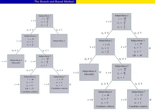

I would disagree with the contentions that subproblems are "inevitable" and that algorithms almost always try to identify and exploit them. What is illustrated in your diagram (a branch-and-bound solution tree) does not really involve "subproblems". A more accurate term for the problems at the nodes would be "restricted problems" or just "restrictions".
Subproblems frequently occur when a problem can be decomposed into smaller, more tractable portions. For instance, a multiperiod production problem might decompose into a set of single period subproblems and a master problem that integrates the single period solutions and handles constraints that link them. Besides decomposing over time, in some cases we decompose problems geographically or geometrically. In one project with which I was involved, we were placing a network of sensors in a body of water. The full model was too large to solve, so we approximated the body of water with a bunch of 3D cubes, made the placement of sensors in each cube a subproblem, and then had a master problem that resolved the connection of the separate networks into a single network.
In addition to decomposition, another source of subproblems is models where a portion of the problem does not fit a mixed integer linear (quadratic, whatever) structure. There are techniques that combine a MILP model containing the elements that are easily modeled with an "oracle" that takes candidate solutions, does mysterious things, and either blesses the solution or conjures up a previously unknown constraint that the candidate solution violates. In the latter case, the new constraint is added to the MILP model and solution of the MILP continues or starts over. The oracle is considered a subproblem.

    There is a matter of terminology here. Treating a discrete problem as a continuous problem is a type of relaxation (in this case by relaxing the integrality constraints). I would not call this a subproblem, but I cannot guarantee that nobody else would. – prubin Feb 16 '22 at 19:01
