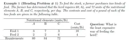

So far, most of the examples that I come across are from introductory textbooks involving some basic example about farmers choosing between different crops to grow based on expected harvest and market price; or some similar example of a factory in which two different machines manufacture different types of items at different speeds, and again based on expected consumer demand, the manager at the factory is expected to decide how much of each machine's workload should be assigned to which type of item. Sometimes, there might be some constraints that need to be taken into consideration. Generally, these problems I come across can be solved using algebraic manipulation or through linear programming.
I posted an example of one of these problems below:
