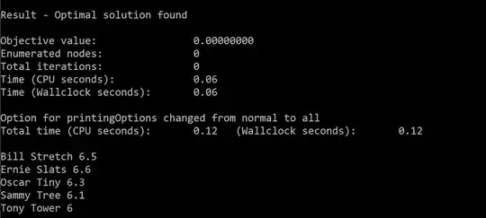

A solution is found in 0.12 seconds with the default open-source CBC solver: enter image description here
And apparently this solution is unique.

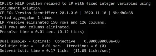

If I run the program with CPLEX, the problem is solved in 0.01 sec: enter image description here

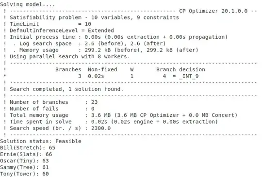

A solution was found in 0.02s: enter image description here
