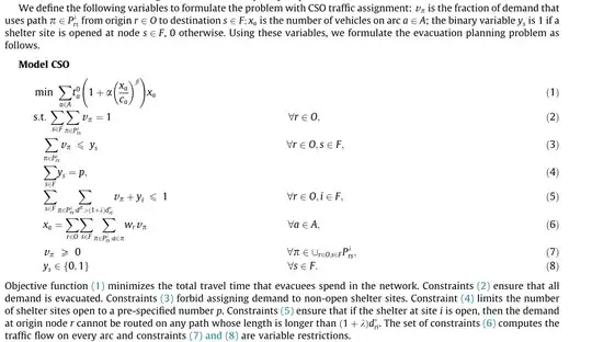

This might be a very basic question for this community. I am reading an article and I think I have some confusion about formulating a problem. My understanding is that all decision variables should be present in the objective function. For any continuous function, the first derivative of the function is zero at the minima or maxima and the value of the variable for which we get the derivative equal to zero is the solution of the problem. However, the article I am reading formulated the problem as follows where some decision variables are present only in the constraints:
The decision variables are $x_a$ ,$v_\pi$, and $y_s$. However, only $x_a$ is present in the objective function. Is it because the coefficients of the absent decision variables might be $0$ in the objective function? If we modify the problem and add the constraints to the objective function like the Lagrange method we will be able to include all variables.

    "For any continuous function, the first derivative of the function is zero at the minima or maxima and the value of the variable for which we get the derivative equal to zero is the solution of the problem." That is true for unconstrained problems, but definitely not true for constrained problems. – prubin Oct 20 '21 at 21:08
  • @prubin, That's right. II mixed up optimality conditions of constrained and unconstrained problems. – mars Oct 20 '21 at 23:24
  • @worldsmithhelper No, thanks so much for clearing up my confusion with the example you provided. – mars Oct 20 '21 at 23:26
This answer complements that by @worldsmithhelper .
Not only does an objective function not have to include all the decision variables, it need not include any of them. An "optimization" problem having a constant (zero) objective function, which is equivalent to not having an objective function, is called a feasibility problem.
Your understanding of the optimality conditions is incorrect when there are constraints. When there are constraints (and suitable differentiability and constraint qualification), the first order optimality conditions are the Karush–Kuhn–Tucker (KKT) conditions, which tie together the gradients of the objective and constraints. In unconstrained problems, the KKT conditions reduce to the condition with which you are familiar; namely, that the gradient of the objective function equals zero.
Edit:Any optimization problem can be transformed, via an epigraph formulation, to an equivalent problem containing only one decision variable in the objective function. This is accomplished by introducing a new decision variable, $t$, making $t$ the objective function, keeping all the original constraints and decision variables, while (in the case of minimization), adding an additional constraint, $\text{original_objective_function} \le t$. By virtue of the minimization, at an optimal solution, $t = \text{original_objective_function}$, hence making the transformation correct. Everything is the same for maximization, except the added constraint is $\text{original_objective_function} \ge t$
