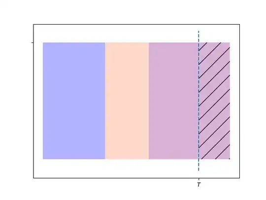

In the simulation, I allowed $t_k$ to evolve until $t_{k+1} \geq T$. I then terminated and recorded $\tau = T - t_k$ and $t_{k+1} - T$. This is then repeated several times in order to plot normalised histograms as simulated pdfs.

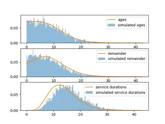

This produces the following. The concern now becomes clear once one looks at the bottom plot. Why is the simulated service duration pdf so biased to the right?. If I look at the middle plot, the misfit is probably due to this bias. I must have not done the simulation properly. Please help me identify the errors.

You have fallen victim to the renewal paradox, a.k.a. inspection paradox, a.k.a. length-biased sampling.
$F_{\Delta}$ is the distribution of service time for the kth customer, but it is NOT the distribution of service time for the customer being served at a preselected time $T$. The very manner of selecting the customer based on observing at a preselected time biases the distribution of service time for that customer. It is not the same as observing the kth customer. Fixing the time and looking at the then current customer is different than fixing the customer and looking at its time.
To make it simple to think about, consider a service time distribution which takes value 1 or 2 minutes, each with probability 1/2. If the system is allowed to run for a long time, about 2/3 of the time the system is running, the customer then being served has total service time of 2, and 1/3 of the time has a total service of 1. So if we preselect a tine $T$ (in steady state), the average total service time for the customer being served at that time = 5/3, not 3/2.
If the service time distribution $F_{\Delta}$ is exponential, then in steady state, the total service time of the customer being served at a preselected time is exponential with mean double that of $F_{\Delta}$, which is the distribution for the kth customer. If you now consider that the exponential distribution is memoryless, if we randomly pick a time at which to observe the remaining (not total) service time of the customer then being served, it should have distribution $F_{\Delta}$, i.e., the total service time of the kth customer. But on average, the preselected time will be halfway through the service time for the customer being served. So how can that be? Because the customer then being served has average total service time equal to double that of the kth customer, and so 1/2 the doubled average is equal to the average for the kth customer, thereby resolving that paradox.

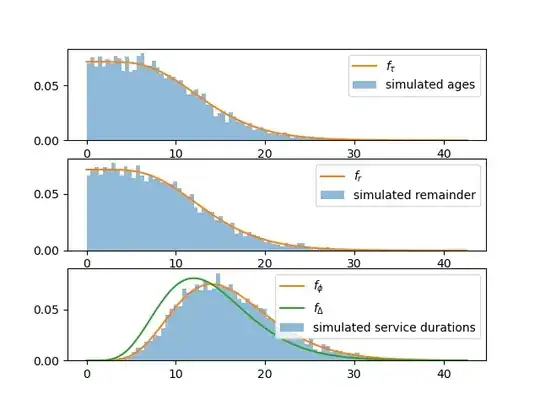

Note: This answer is intended to show what I have learned from the valuable answer provided by @Mark L.Stone. His post answered my question of why the simulation is biased. Hence, this post provides only additional insight. I chose to post it as an answer and not an edit due to the original question already being lengthy.

Service time distribution of customer observed at time $T$
Let us denote the service time distribution of a customer observed at time $T$ by the random variable $\phi\sim F_{\phi}$ where $F_{\phi}$ is its cdf and $f_{\phi}$ is its pdf. Interest lies in $f_{\phi}$ due to its use in computing expected values. It will also be used to derive $f_r$ and $f_{\tau}$.
As noted by Mark and the simulation experiments, $f_{\phi} \neq f_{\Delta}$. We can argue the following about $f_{\phi}$ by reasoning in terms of $P(t \leq \phi \leq t + dt) = f_{\phi}(t) dt$ $$ \begin{align} f_{\phi}(t)dt & \propto \mbox{length of observed service interval}\\ & \propto t \end{align} $$ and $$ \begin{align} f_{\phi}(t)dt & \propto \mbox{frequency of service intervals with length } \phi\\ & \propto f_{\Delta}(t) dt. \end{align} $$ Hence we have $$ \begin{align} f_{\phi}(t)dt & \propto t f_\Delta(t) dt\\ & = \eta\, t f_\Delta(t) dt \end{align} $$ where the constant of normalisation has closed form $$ \begin{align} \eta & = \left( \int_{0}^{\infty} \Delta f_{\Delta}(\Delta) d\Delta \right)^{-1}\\ & = \frac{1}{\mathbb{E}[\Delta]} \end{align} $$ which yields $$ f_{\phi}(t)dt = \frac{t f_\Delta(t) dt}{\mathbb{E}[\Delta]} $$ such that we obtain the desired result $$ f_{\phi}(t) = \frac{t f_\Delta(t)}{\mathbb{E}[\Delta]} $$
Process age $f_{\tau}$
If we have observed/inspected service duration $\phi$ then the service age $\tau$ at observation $T$ should be uniformly distributed as $\tau \in [0,\phi]$. We now reason that $P(\tau \leq t \mid \phi) = t/\phi = F_{\tau}(t\mid \phi)$. Take the derivative with respect to $t$ $$ \begin{align} \frac{dF_{\tau}(t|\phi)}{dt} & = \frac{1}{\phi}\\ \therefore dF_{\tau}(t|\phi) &= \frac{dt}{\phi} \\ & = P(t \leq \tau \leq t + dt| t \leq \phi) \\ & = f_\tau(t|\phi) dt \end{align} $$ We are not interested in the conditional. Hence $\phi$ needs to be marginalised out. $$ \begin{align} P(t \leq \tau \leq t + dt) & = f_\tau(t) dt\\ & = \int_{0}^{\infty} f_\tau(t|\phi)\,dt \, f_{\phi}(\phi) \mathbb{1}_{\{t\leq \phi\}} \,d\phi\\ & = \int_{t}^{\infty} \frac{dt}{\phi} f_{\phi}(\phi) d\phi\\ & = \int_{t}^{\infty} \frac{dt}{\phi} \frac{\phi f_{\Delta}(\phi)}{\mathbb{E}[\Delta]} d\phi \\ & = \frac{1}{\mathbb{E}[\Delta]}\left( 1 - \int_{0}^{t} f_{\Delta}(\phi)\,d\phi\,dt \right) \\ & = \frac{1 - F_{\Delta}(t)}{\mathbb{E}[\Delta]}dt\\ & = \frac{\bar{F}_{\Delta}(t)}{\mathbb{E}[\Delta]}dt\\ \therefore f_\tau(t)&= \frac{\bar{F}_{\Delta}(t)}{\mathbb{E}[\Delta]} \end{align} $$ where $\bar{F}_{\Delta}$ is the survival function of the per $k^{th}$ customer service distribution $\Delta_k$.
Remaining/residual lifetime
The same process can be followed to obtain $f_r$. However, doing so will only confirm $f_{\tau} = f_r$. The simulations also confirm this.

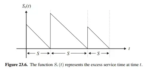

Renewal-reward theory
The work up to now comes from the first reference. The second reference takes a renewal-reward theory perspective and places emphasis on finding $\mathbb{E}[\tau]$ and $\mathbb{E}[r]$. It argues that if the system is ergodic then the time-average of a renewal cycle should equal the ensemble average of a cycle (i.e. it expectation). In other words, if we let a renewal cycle constitute a service duration then $$ \begin{align} \mathbb{E}[r] & = \frac{\mathbb{E}[\mbox{total } r \mbox{ earned over }\Delta]}{\mathbb{E}[\Delta]}\\ & = \frac{\mathbb{E}\left[\int_{0}^{\Delta}(\Delta - r)dr\right]}{\mathbb{E}[\Delta]}\\ & = \frac{\mathbb{E}[\Delta^2]}{2\mathbb{E}[\Delta]}. \end{align} $$ The below figure (from the second source) should make this idea clear where $r = S_e$ and $\Delta = S$.
The same can be done for $\mathbb{E}[\tau]$ where the triangles grow in reverse. The result should be $\mathbb{E}[r] = \mathbb{E}[\tau]$.

Updated code/experiment
# Additional functions
def f_phi(t,f_delta): return t*f_delta.pdf(t)/f_delta.mean()
def f_r(t,f_delta): return f_delta.sf(t)/f_delta.mean()
def f_tau(t,f_delta): return f_r(t,f_delta)
if name == 'main': # Setup simulation alpha = 0.9999 # almost 1 e.g. 1 - 1e-6 # f_delta = norm(loc=15,scale=3) f_delta = gamma(a=0.5,scale=28) # high cv2 = 2 # f_delta = gamma(a=3,scale=14/3) # cv2 just below 1 # f_delta = gamma(a=7,scale=2) # low cv2 # f_delta = gamma(a=14,scale=1) # very low cv2 # f_delta = gamma1,(scale=14) # cv2 = 1 cv2 = f_delta.var()/f_delta.mean()**2 T = 1000/2 # Run long enough to reach steady state (bit extreme maybe?) samples = 5000 # Need a reasonable amount of iid samples # Perform simulation tau,r,delta = sample_interrupted_services(f_delta,T,samples) # Plot empirical pdfs fig,ax = plt.subplots(3,1) ax[0].hist(tau,bins=80,density=True,alpha=0.5,label='simulated ages') ax[1].hist(r,bins=80,density=True,alpha=0.5,label='simulated remainder') ax[2].hist(delta,bins=80,density=True,alpha=0.5,label='simulated service durations') # Plot algebraic counterparts for comparison t = np.linspace(0,f_delta.ppf(alpha),200) ax[0].plot(t,f_tau(t,f_delta),label='$f_{\tau}$') ax[1].plot(t,f_r(t,f_delta),label='$f_r$') ax[2].plot(t,f_phi(t,f_delta),label='$f_\phi$') ax[2].plot(t,f_delta.pdf(t),label='$f_{\Delta}$') bias = f_delta.moment(2)/(f_delta.moment(1)) - f_delta.moment(1) empirical_bias = delta.mean() - f_delta.mean() print('Algebraic bias: ',bias) print('Empirical bias: ',empirical_bias) # Show legend/labels _ = [ax[i].legend(loc='upper right') for i in range(3)] fig.show()
Note: some different options with regards to $C_V^2$ values have been given. We run the experiment for $C_V^2 = 2$ and get a bias of $28$ as opposed to the previous simulation where $C_V^2 = 0.143$ gave $\beta = 2$. Here is the new experiment.
