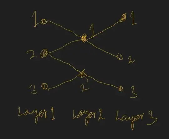

Consider a graph whose vertices can be partitioned into $n$ layers. Edges exist only between vertices in successive layers. So, there are edges between layers $1$ and $2$, between layers $2$ and $3$ and so on but never between layers $1$ and $3$ (since they are not successive layers) nor between vertices in the same layer.
An example of such a graph with three layers is shown in the figure below.
Now, I want to number the vertices in each layer from $1$ to $m_i$ (with $m_i$ being the number of vertices in layer $i$) in a way that the vertices at the two ends of any edge are as close in number as possible. We can think of an objective function that is the sum of squared differences of the numbers assigned to the vertices connected by each edge, across all edges.
Is there an efficient algorithm that can do this?

  • I don't get the question. You can walk from one node to another along the edges. If there is no path between two nodes which could very well happen, I think you can't walk between them. The graph is bipartite because you can group the odd-layers on one side (left) and even layers on the other side (right) with connections only going between the two sides. Don't think you can partition it into two disconnected parts. – Rohit Pandey Jul 02 '21 at 05:59
I don't know whether this will be efficient enough for your real graph sizes, but with binary decision variables $x_{v,k}$ to indicate whether vertex $v$ is assigned label $k$, you can obtain a formulation that looks a lot like the quadratic assignment problem. Let $V_i$ be the set of vertices in layer $i$. The problem is to minimize $$\sum_{(v,w)\in E} \sum_{k_v, k_w} (k_v-k_w)^2 x_{v,k_v} x_{w,k_w}$$ subject to \begin{align} \sum_{k=1}^{m_i} x_{v,k} &=1 &&\text{for layer $i$ and $v\in V_i$}\\ \sum_{v\in V_i} x_{v,k} &=1 &&\text{for layer $i$ and $k\in\{1,\dots,m_i\}$} \end{align}

Maybe this can work?
Numbering is same as sorting. Disregard the layers and treat the whole thing as a single graph. Use Cuthill-Mckee (if the bandwidth is low) or other heuristics for the graph bandwidth problem to find the big ordering of nodes. For each layer, filter out the nodes of other layers in the big ordering to get the ordering of nodes in that layer.
Wikipedia says the graph bandwidth problem is also called linear graph placement. Linear placement means moving all the nodes to a regular grid on a 1D line, and minimize the distances between the connected nodes by sorting the nodes on that 1D line.
Here is what I guess:
layer 2:      1 - 2
layer 1:    1   2
vs - /
big layer: 1-2-3-4
The best ordering on one 1D line is same as the best ordering over multiple lines. The relationships between the nodes in the two cases (big layer and multiple layer) are the same. Since sorting only depends on the relationships, the ordering doesn't change.

  • I'm afraid this method doesn't work on even the small toy example in my question. See here: https://gist.github.com/ryu577/0e664ae50128c2aa0ec4784a36d933c5 – Rohit Pandey Jul 02 '21 at 08:16
    The adjacency matrix is not symmetric. There is an extra 1 in the last row. Cuthill-Mckee would at least work for approximately minimizing the bandwidth of a single-layer graph with low bandwidth. search for Cuthill-Mckee in https://en.wikipedia.org/wiki/Graph_bandwidth See also reference 7. – Qurious Cube Jul 02 '21 at 14:08
  • @RohitPandey If it doesn't work, why is it selected as the correct answer? – prubin Jul 04 '21 at 00:04
  • He pointed out a bug in my code. Once I fixed it, it worked. These are very simples test cases though. I'm working on compiling more. – Rohit Pandey Jul 04 '21 at 00:07

  • @QuriousCube The GA has a boatload of parameters. I used an "island" model, which in addition to the usual parameters (crossover points, mutation rate, population size, elitism, stopping criteria) has a few couple of additional parameters (number of islands, frequency and size of migration between islands). I did not invest any energy in tuning them, so I can't say how much impact they have on efficiency. To answer that would require a large scale experiment. – prubin Jul 05 '21 at 15:23
    @RohitPandey If you know the optimal vertex sequence, the problem is solved. I put my Java code at https://gitlab.msu.edu/orobworld/vertexnumbering. You will need CPLEX to run it, as well as two open source libraries (links in the README file). – prubin Jul 05 '21 at 16:16
Treat nodes in 1st and 3nd layer as extra edges in the 2st layer to make a merged layer. Minimize bandwidth of 2nd layer. Repeat for the other layers.
layer 2: o   o   o
layer 1:   @   @
@ becomes an edge:
layer 2: o - o - o ```
Qurious Cube
  • 523
  • Sorry, don't understand treating 1st and 3rd layer nodes as extra edges. Also, how can I minimize the bandwidth of only one layer? There are no edges between the vertices of a given layer. – Rohit Pandey Jul 02 '21 at 07:13
