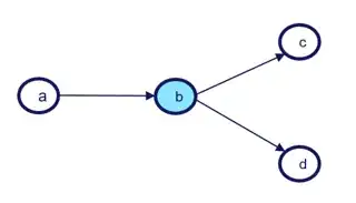

I am working on a variation of the multicommodity flow problem on a graph $G=(V,E)$. I have requests $r_{uv}$ for pairs of nodes $(u,v), u\in V, v\in V$, which means that $r_{uv}$ units of flow must be shipped from node $u$ to node $v$.
The variation of the problem is twofold:
  1. There are capacity constraints on the edges of the graph: when the total flow on an edge $(i,j)\in E$ exceeds a given threshold $Q$, an integer variable $N_{ij}$ is incremented, so that $$ N_{ij} = \Bigg\lceil\frac{{\rm flow}_{ij}}{Q} \Bigg\rceil $$ A weighted sum of the $N_{ij}$ is minimized in the objective function. You can interpret $N_{ij}$ as vehicles with capacity $Q$, transporting units of flow.

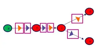

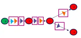

  2. Transshipment cannot be performed in some vertices of the graph. This means that in these specific vertices, a unit of flow cannot be transferred from a given vehicle to another. As an example, consider the graph below, with two requests: $1$ unit from $a$ to $c$, and $1$ unit from $a$ to $d$. Also, let $Q=2$.

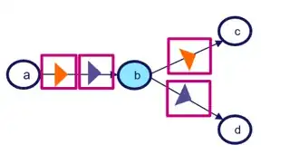

If transshipment is allowed in node $b$, then the following flow is feasible, yealding $N_{ab}=1$ ($N_{ij}$ is represented by the purple squares, flows are represents by the filled triangles):
Since transshipment is allowed, all the units of flow can be packed in one vehicle on edge $(a,b)$; and then one of the two demands, $r_{ac}$ or $r_{ad}$ can be transferred to another vehicle when arriving in node $b$.

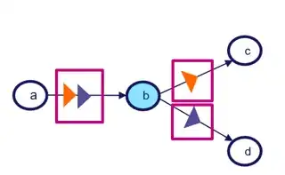

Now, if transshipment is not allowed, this is not a valid configuration, and both requests must be in individual vehicles on edge $(a,b)$, as follows:

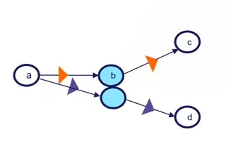

The way I currently cope with transshipment constraints is by duplicating vertices when I need to. For example, for the above example, I use the following graph:
This way, it is guaranteed that both requests are not in the same vehicle on edge $(a,b)$, and so the transshipment constraint is satisfied structurally.

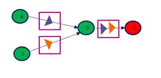

First example: we have two requests $r_{ad}$ and $r_{cd}$. The nodes in green are transshipment nodes, and the node in red is not. Since $b$ is a transshipment node, all requests can be packed together on edge $(b,d)$.

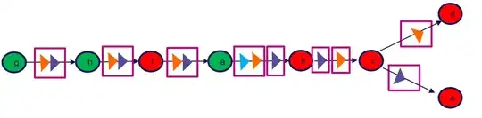

Another example with requests $r_{gd}, r_{ge},r_{ab}$. Although $f$ is not a transshipment node, merging the requests is possible. Requests $r_{gd}$ and $r_{ge}$ must be split in node $a$, which is a transshipment node.
