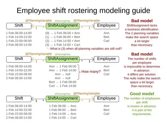

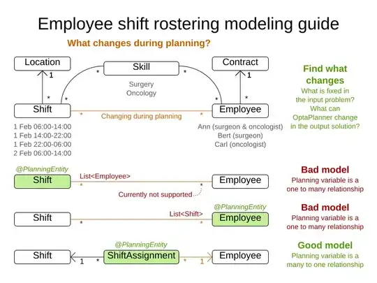

You might find OptaPlanner's domain modeling guide (Docs section 20.2) useful.
It's a step by step guide on how to design a good model - and explains why some models are better or worse than others. Here's a few examples of good vs bad models:
Modeling guide
Geoffrey De Smet
